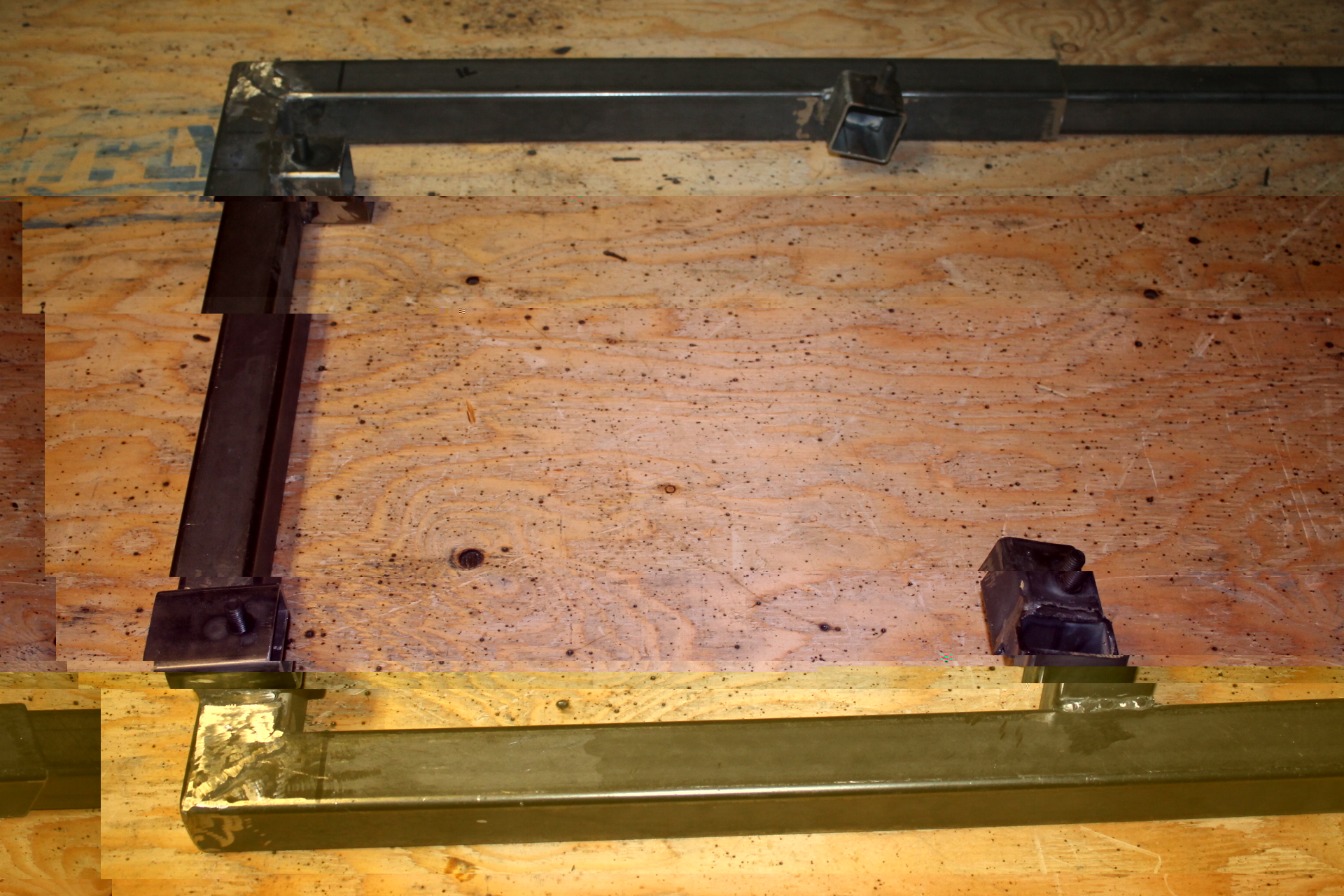

Those with a keen eye may have noticed in the photo above that the rig frame is no longer square. As I welded the corner mounts, it drew in the ends (i.e. where the two halves join) inwards by a full ½”. I had slid the front and rear halves together thinking that would prevent any warpage, but I was wrong. This meant the two halves were stuck together. Try as I might, I could not physically separate them (i.e. slide the front half out of the rear half). :oops:
Wondering how the hell I was going to separate the two pieces, I had an ingenious thought to use my winch. So, I anchored one end of the rig frame with a tow rope and hooked up my 2000 lb winch to the other and started pulling… To no avail. Not even the winch could separate them! :shock:
As a last resort, I grabbed my angle grinder with cut-off wheel and cut the damn thing apart. Ugh. Ended up shortening one side of the front section by 6”.
Now that I had them apart, what to do next? They’re not square, they won’t slide into one another. How the hell am I going to make them square again? :?
Then a lightbulb went off in my head… Perhaps I can use my 12-ton shop press somehow to bend them square again. To my delight, it worked! I managed to get both halves square using the shop press in ways it surely was never designed to be used. lol
That’s where I left off. With the cut / shortened side of the front section, I lost about 6” of length. By my rough calculations, setting my rig to my preferred length will mean that only about 1” of the cut side will be inserted into the rear half. I might have to forgo the length adjustability and just weld the two halves together. Probably the simplest solution.

Yep, welding distortion can be a pain. You might have got away with it by temporarily putting a piece(s) between the legs to act as a spacer. Another trick is to start with things out of square and then when the weld cools it will draw it back square. On a 45 tube corner joint like that about 1/6-1/8' out at 12" will usually draw back in (assuming welding from outside corner to inside). Depends on weld size and weld sequence but can usually get it close with a little practice. With the diagonals you would have had to add a bit more.
PostPosted: Fri Mar 30, 2018 7:42 pm
Yes a spacer would have helped a lot. Live and learn.
