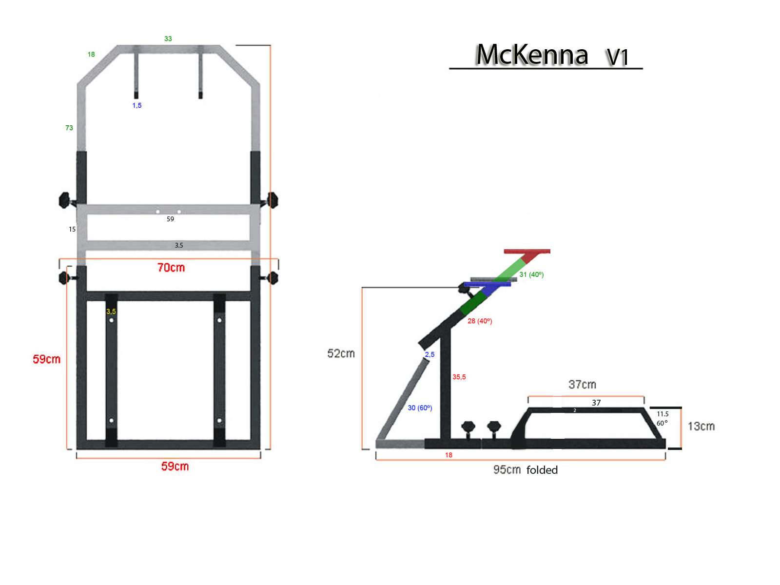

Here’s the design I’m going to base the new rig on. It will be adjustable, but in the future I might weld it solid once I have it set how I want it.
Mine will also be on caster wheels, have a partial floor, a deck for holding the SimuCUBE, and have provisions for mounting bass shakers.
I picked up about 40 feet of square tubing last week, and started to build it last weekend. I'll post photos as I progress.

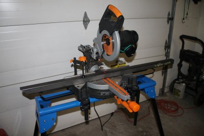

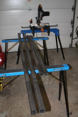

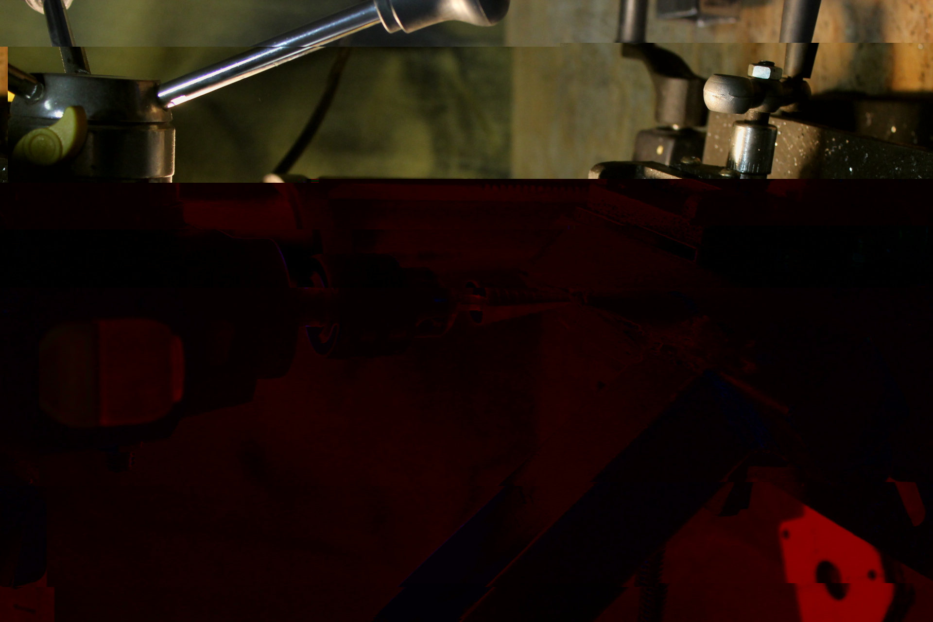

When I build my monitor stand (steel square tube) I used a chop saw (w/ abrasive cut-off disc) to cut all the pieces. While it did the job, it wasn't very precise nor particularly fast. Depending on the angle, some cuts took forever to complete.
Since then I've purchased multipurpose miter saw, which can cut virtually anything, and it’s much more accurate and fast. I cut my first metal with it on the weekend and it sliced through like hot butter.
Here's the base cut out.

Well the blade on my multipurpose miter saw didn't last long. Probably about 30 cuts and it was dull as could be. Certainly not the 750 metal cuts it was advertised to provide. :lol: Ended up having to dig out the chop saw.

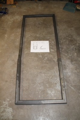

Got the wheel deck pieced together.

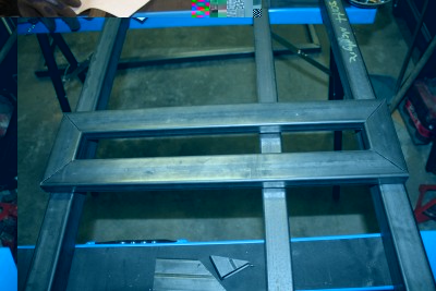

Then I worked on the vertical stands for the wheel deck.

This looks really good. I have a Playseat Challenge, which is great for the price, but it's pretty awkward to get in and out of. I'd really like to do a rigid one like this as well.
FYI I have that Evo saw and I put this blade on it. https://www.amazon.ca/gp/product/B002PM ... UTF8&psc=1 I cut through a couple of pieces of Class IV receiver hitch tubing and it seems to be holding up pretty well. It goes on the Rage saw label facing in, I have a feeling the bad reviews on there are from people putting it on backwards.

Yeah, I know of a couple other people with the same saw and they too found the stock blade didn't last long when cutting metal. Hiscott got that same Oshlun blade as you for his saw and tells me it is lasting him forever.
I decided to try a Freud Diablo Steel Demon Cermet II Carbide Metal Cutting Blade due to its great reviews. Cermet is supposed to be even more durable than carbide. We shall see. Hopefully it arrives by the weekend so I can get back to cutting.

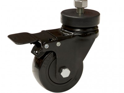

I did find some awesome caster wheels though. They're made for a tool cabinet and support 165 lbs each. They have integrated brakes which not only lock the wheel rolling, but prevent it from swiveling as well. And as an added bonus, they included anti-vibration rubber spacers. Should be perfect!

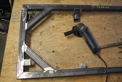

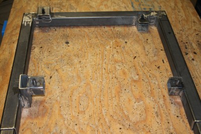

Got the shaker mounts welded up. Basically, I just welded a diagonal tube across in each corner, then welded a steel plate over top to create a smooth flat surface to bolt the shakers to. My plan is to drill and tap mounting holes through the plate (and tube underneath).

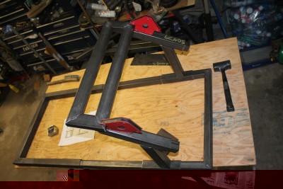

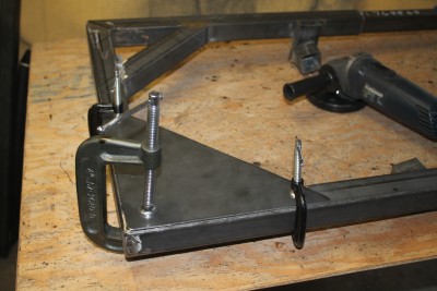

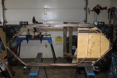

Those with a keen eye may have noticed in the photo above that the rig frame is no longer square. As I welded the corner mounts, it drew in the ends (i.e. where the two halves join) inwards by a full ½”. I had slid the front and rear halves together thinking that would prevent any warpage, but I was wrong. This meant the two halves were stuck together. Try as I might, I could not physically separate them (i.e. slide the front half out of the rear half). :oops:
Wondering how the hell I was going to separate the two pieces, I had an ingenious thought to use my winch. So, I anchored one end of the rig frame with a tow rope and hooked up my 2000 lb winch to the other and started pulling… To no avail. Not even the winch could separate them! :shock:
As a last resort, I grabbed my angle grinder with cut-off wheel and cut the damn thing apart. Ugh. Ended up shortening one side of the front section by 6”.
Now that I had them apart, what to do next? They’re not square, they won’t slide into one another. How the hell am I going to make them square again? :?
Then a lightbulb went off in my head… Perhaps I can use my 12-ton shop press somehow to bend them square again. To my delight, it worked! I managed to get both halves square using the shop press in ways it surely was never designed to be used. lol
That’s where I left off. With the cut / shortened side of the front section, I lost about 6” of length. By my rough calculations, setting my rig to my preferred length will mean that only about 1” of the cut side will be inserted into the rear half. I might have to forgo the length adjustability and just weld the two halves together. Probably the simplest solution.

Yep, welding distortion can be a pain. You might have got away with it by temporarily putting a piece(s) between the legs to act as a spacer. Another trick is to start with things out of square and then when the weld cools it will draw it back square. On a 45 tube corner joint like that about 1/6-1/8' out at 12" will usually draw back in (assuming welding from outside corner to inside). Depends on weld size and weld sequence but can usually get it close with a little practice. With the diagonals you would have had to add a bit more.
PostPosted: Fri Mar 30, 2018 7:42 pm
Yes a spacer would have helped a lot. Live and learn.

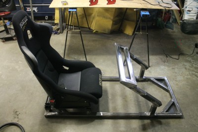

Still quite a bit to do, but it's starting to resemble a rig.

PostPosted: Mon Apr 02, 2018 9:00 am
What’s the seat belt for? :roll:
I took the seat straight out of the Talon. My plan is to use the Sparco in my rig while I'm not driving the Talon (offseason), then when I am driving the Talon, I'll put the Sparco back in the car and put the Talon's stock seat on the sim rig. That way I get to use my Sparco year around instead of it sitting in the car collecting dust.

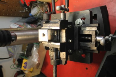

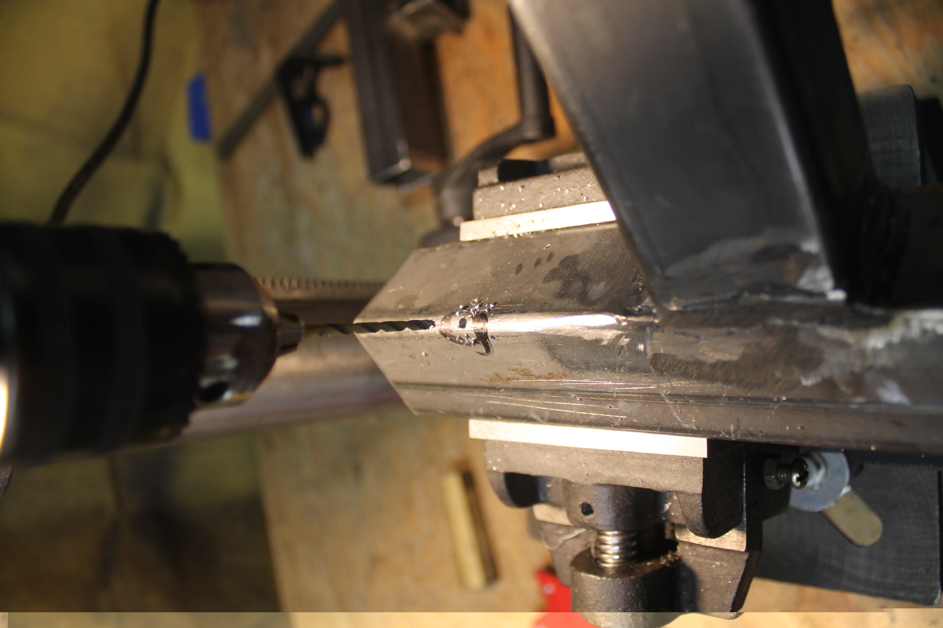

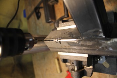

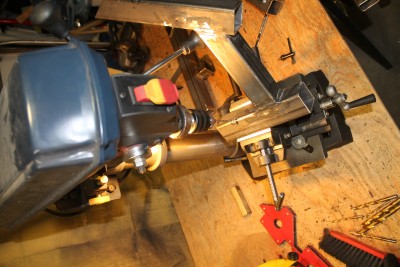

For the adjusters, I am using 10mm Hex Coupling Nuts and just regular 10mm bolts. To drill the edge / corner of the steel square tubing, I simply used a punch, the place the tubing in my drill press vice and started with a small drill bit and gradually worked my way larger, until I got to the point I could use a step drill bit. Worked great.

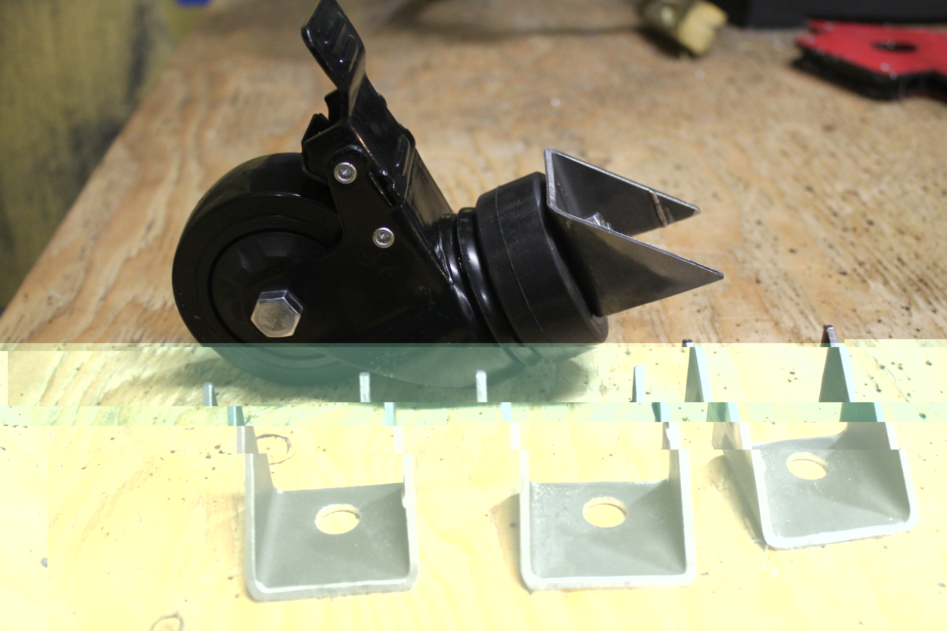

For the caster wheel mounts, I'm just going to weld some 45° cuts of the 1-3/4" steel square outside of the frame. I'll attach them flush with the bottom of the frame so the wheels will be supported partly by this little "wings" and partly by the frame itself. More pictures to come soon.

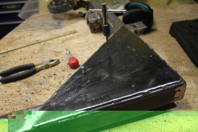

Last night I drilled and taped all 16 holes for mounting the bass shakers, then started work on the frame for the pedal plate. I learned from past mistakes and used a wood spacer this time to keep the bars square.

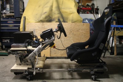

Here's the rig with everything mounted. I weighed it again and this time it was 185 lbs! :lol:
You'll note that it's still just bare metal. I wanted to try using it for a while before I paint it, just in case I end up doing some final alterations.
I have to say though, after using it for an hour last night, I am very pleased with the result. It is solid as a rock. With the lockable caster wheels, the rig it has zero movement when locked in place. And when unlocked, the rig is even easier to move around than my old MDF rig. Very happy. :D
