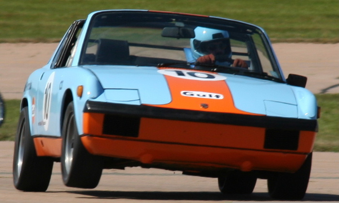

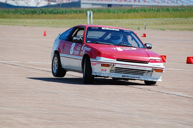

PostPosted: Tue Jan 20, 2015 10:14 am
Evan Williams wrote:
...which must always be in contact with the ground
...which negates pretty much everything I drive:
Image thanks to Gordon?
Image thanks to Harold
