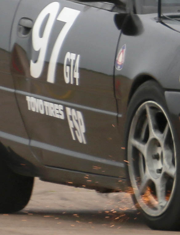

In reviewing photos from Saturday, I see that Leon sheds brake sparks too:
_ Harold
PostPosted: Fri Aug 08, 2014 10:00 am
_ Harold
Haha, makes sense. I got the pads from Carl Wener. Also, new rotors and caliper on that side on Friday night.
Thanks for the picture Harold!

PostPosted: Fri Aug 08, 2014 10:20 am
_ Harold
Hmmm...could this be qualified as "real time" weight reduction !! :P :orglaugh:
PostPosted: Fri Aug 08, 2014 10:24 am
doubt it.. since all dust ends up clinging to the car right after :mrgreen:
maybe more along the lines of active weight distribution...
