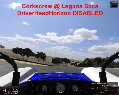

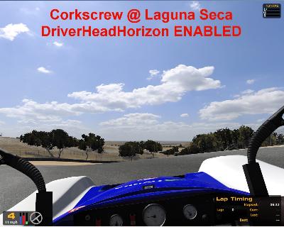

Actually Stacy, after Motion Cockpit View was developed, iRacing added an equivalent feature to its build. So Motion Cockpit View has been rendered obsolete now.
The built-in iRacing feature is referred to as DriverHeadHorizon and DriverRotateHead. I use it myself and find it very helpful in feeling when the car is understeering and feeling the track's camber / elevation changes.
Here's a couple forum links that explain it in detail:
    Image Image Image
After experimenting with different values, here are the settings I chose to use:
Code:
[View]
DriverHeadHorizon=0.750000                 ; Percent to allow the drivers head to stay level with the horizon when the car tilts.
DriverHeadNoPitch=0.750000                 ; Percent to allow the drivers head to stay level with the horizon when the car pitches.
DriverHeadWobble=1.000000                  ; Percent to allow the drivers head to wobble when going over bumps.
DriverRotateHead=0.200000                  ; Percent to rotate drivers head with slip angle. 0 to 1 with 1 being 100%
